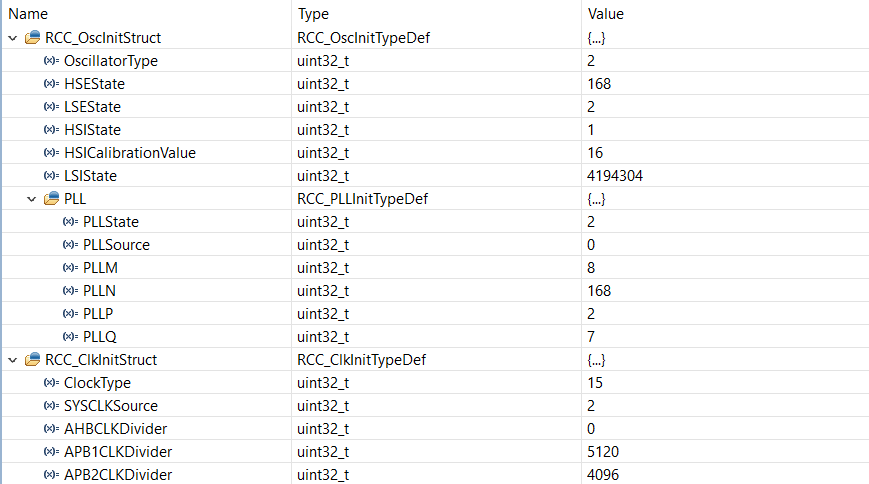

2018-04-11 2:17 PM
I did some bug and get system clock information as followed:
Do you think it is ok?

2018-04-11 2:31 PM
I don't know. There are too many things that may go wrong between setting a structure and actually having the regsiters set up - including the oscillator may be running or not.
Why don't you output the system clock onto a MCO pin, and measure it? That's a sure way to know what is its frequency.
