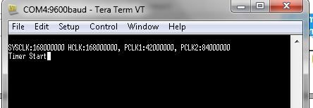

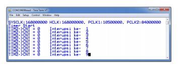

2015-11-07 6:50 AM
Misspelled the name of the handler, and referencing TIM6?
void TIM2_IQRHandler(){ if(TIM_GetITStatus(TIM2,TIM_IT_Update)!=RESET){ TIM_ClearITPendingBit(TIM2,TIM_IT_Update); counter=TIM_GetCounter(TIM6);We’re moving the ST Community to a new platform to give you a better and more reliable community experience.
