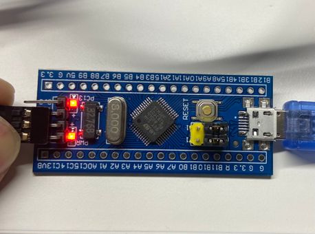

Board I am using is this. Looks like genuine STM32F103C8T6 chip.
I could upload USB_DEVICE successfully with this chip.

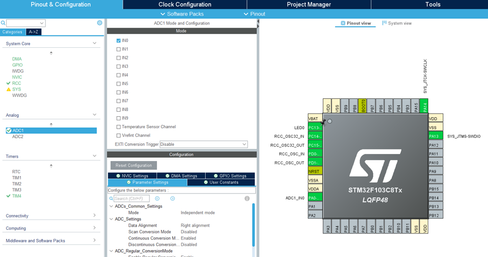

For the test, I only enabled TIM4 counter up mode with Global interrupt and ADC1 as DMA.

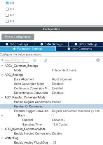

ADC channels are set as below.

Oh yes. Increasing sampling time from 13.5 cycles to 28.5 cycles solves the problem.
I never thought high sampling rate can cause CPU to halt rather then not updating ADC values.

You think this chip is fake?
I have some experience with fake chips cannot handle USB CDC or HID device properly but this chip is working OK even when I setup as USB HID device.
2023-09-11 10:04 AM
The linked discussion indicates, that it's very likely. I don't have personal experience.
