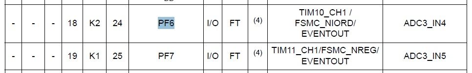

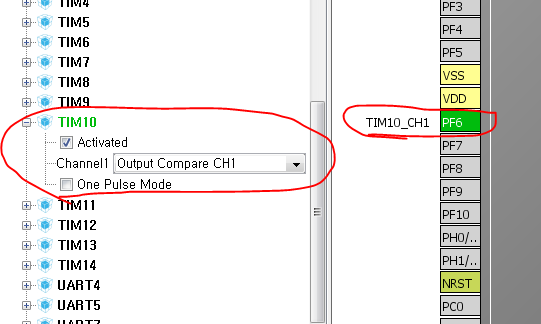

Only few of pins can be used for a certain function (or maybe only one). Press CTRL and click on the pin which is selected by default (PF6 in your case). All other possibilities will be coloured in blue.
2017-10-01 1:38 AM
Thank you Obid.Matic have a nice day
2017-10-01 5:49 AM
PF7 would need to use TIM11, no relationship to TIM10 available

I found dataSheet thanks to you
