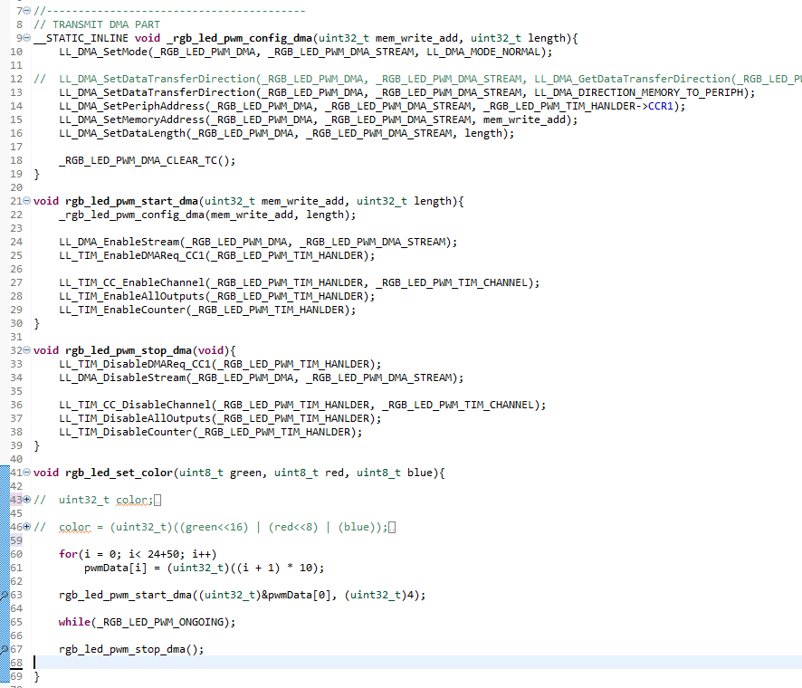

I am trying to use dma with timer 2 in order to change the dutty cycle of a pwm output in each cycle. However, I get a dma transfer error.
2022-04-28 2:14 PM

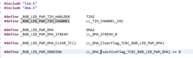

I could solve. I have not referencing correctly the pointer of ccr1
(uint32_t)&_RGB_LED_PWM_TIM_HANLDER->CCR1

Which STM32?
Read out and check/post content of TIM and relevant DMA registers.
2022-04-28 2:14 PM
