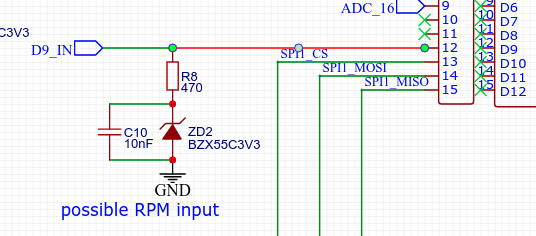

*EDIT: I might have smoked this input. I made a mistake in my wiring:
so I accidentally put 6-7.5 V at unlimited current to it. But I still don't understand the GPIO Modes.

I think I blew this input (see edit to previous post), so now it acts like a short to the 3.3v supply (and it doesn't work with the signal generator anymore). I was pretty confused for a while by the whole unfortunate sequence of events.
2022-01-24 9:49 AM
Yep, shorting to 6.5V is sure to blow something’s. Sounds like the upper protection diode is shorted out. I would be surprised if that’s the only issue.
