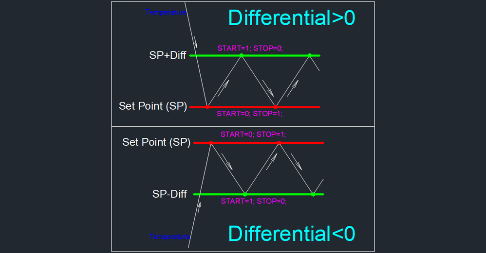

TDK sorry, you are right it is not Hysteresis.
I mixed up with it.
It's just Thermostat with Set Point, which has Differential value for start and stop.
Depend on this Differential value, it should works in opposite ways.
I corrected my code, do not confusing with Hysteresis.
In attached picture, shown the principle how the Thermostat should work.
I implemented it in Function, but have problem with Differential<0. It's operating like differential is equal to 0.
When Differential>0, all works fine.
I know, it's looks like simple task, but I stuck with it and cannot find the mistake.
