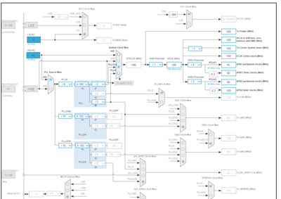

PH0 and PH1 are used by the HSE - High speed crystal oscillator for precise clock and get right UART baudrate , if PH1 is configured as GPIO , the system will run on internal HSI and your UART baudrate will be lost and so stopping at application level . Can you check your clocks ?

but the HSE is already disabled, I am using the internal clocks
