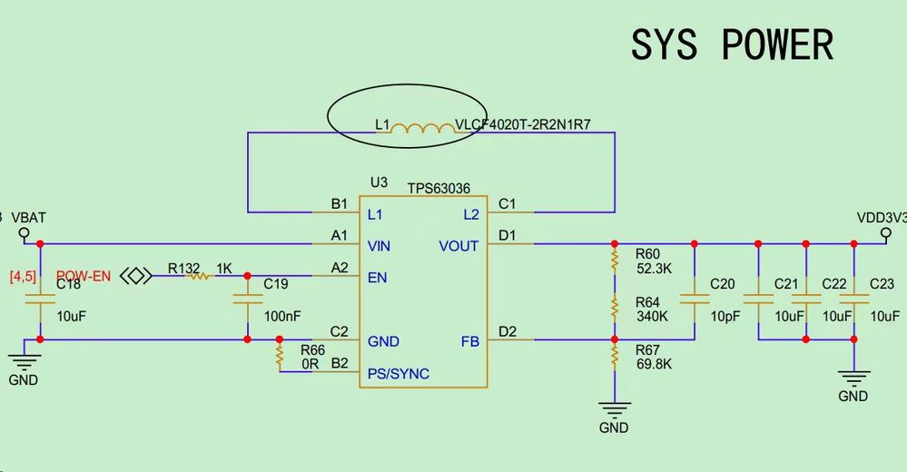

We tested the RTC clock and found a phenomenon that the system kept VDD3.3V in standby state and then disconnected VDD3.3V in standby state, but the RTC clock did not run slowly. If the system controlled automatically and disconnected VDD3.3V in sleep state (3.3V is controlled by the I/O pin pull up enable), The RTC clock will run slowly. It is clear in the L431 manual that VDD and VBAT are automatically switched.
In conclusion, after the chip enters standby mode, the RCT is normal when the VDD is disconnected. When entering low power mode and disconnecting VDD at the same time, RTC running slow will occur.

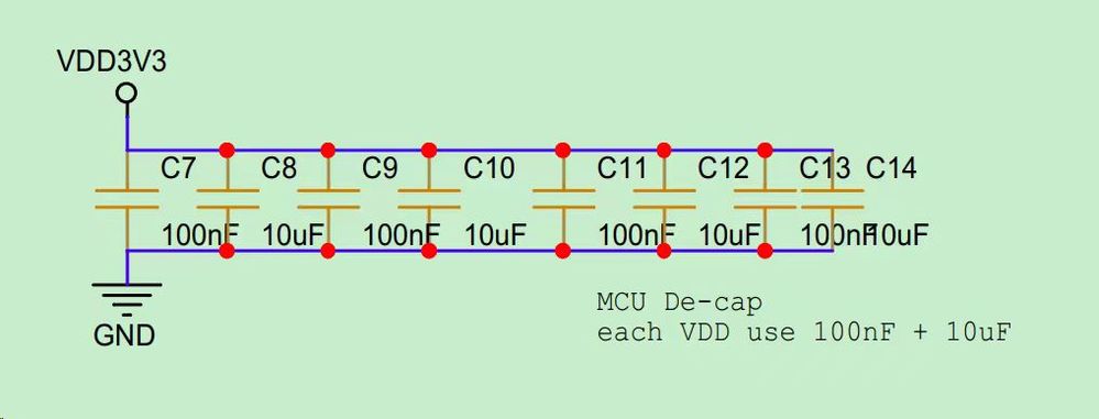

I would like to know whether this simultaneous switching is feasible, and if so, what are the possible reasons for this phenomenon of slow RTC? VDD switching to VBAT is done automatically. How long does the switching time take? Each VDD pin is equipped with a 100nF+10uF capacitor.
