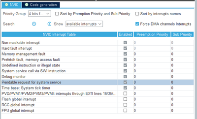

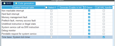

I'm sharing my solution in my case. Using Stm32 Cube IDE 1.12.1 and Nucleo G491RE. Systick interrupt stopped to work after I switched from HAL to LL version in Project Manager -> Advanced Settings for all peripherals including RCC. Later, during the investigation of this problem, I found that CubeMX dialog shows tooltip stating that system interrupts are always allowed, not need to be allowed. But, after I add following line in User code zone, systick interrupt starts to work:

2023-05-04 3:26 AM
This is slightly misleading.
Interrupts are generally enabled at two places: at the source (here: in the Systick module), and in NVIC.
System interrupts indeed don't need to be enabled in NVIC, but they still need to be enabled at the source (except HardFault and NMI (although sources of NMI may still need enabling)).
Corollary is, don't blindly trust the clicking interfaces. Mcu works out of the registers, not out of whatever you've clicked, not even out of C source code nor libraries.

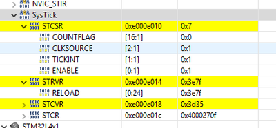

Hi Tmark.14,
I am having the same issue with STM32L431CBT6. I am using STM IDE cube 1.14 and STlink-V3.
I checked the system tick. it is running.
The SysTick_Handler(void) is never getting called.

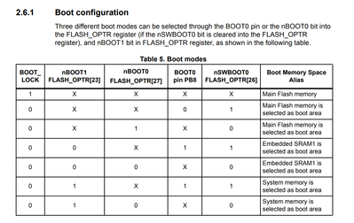

For anyone like me who wants more of an explanation to this solution, here is what the problem is and how I fixed it.
Problem:
The systick interrupt is not working because the MCU would bootup in system memory and the vector table was not properly mapped. The reason it is booting up in system memory is because apparently, ST made a revision where the nSWBOOT0 pin is set high - STM32G474 default option bytes configuration - STMicroelectronics Community
When nSWBOOT0 is set high, if BOOT0 is also high, the controller loads into system memory.
The really messed up part is that I was originally using a STM32G474RET6U ( U suffix means it's from nucleo board) and this would load correctly into FLASH. Then I purchased some individual STM32G474RET6 MCUs and wouldn't work with the same exact code. So at some point ST decided to change the option bytes register that enables nSWBOOT0 by default.
Solution:
Referring to table 2.6.1 above, there are multiple solutions to start loading in FLASH memory. The easiest option is to pull down the BOOT0 (PB8) pin but I am using this pin for CAN GPIO pin. The other options are either setting nSWBOOT0 to 0 by rewriting option bytes, refer to RM0440 section 5.4.2. Or Setting BOOT_LOCK high to override all other combinations.
In case you don't want to download STMCubeProgrammer to do this, or spend hours writing your own routine for this, I have provided what worked for me. I clear nSWBOOT0 and set BOOT_LOCK bit but you could fix the problem by just changing either one.
