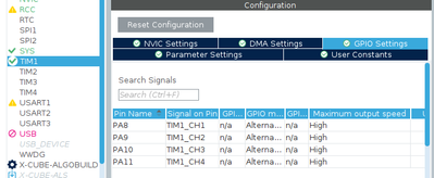

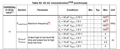

+ on F407: for max. slew rate : set pin speed very high, makes about 2 ns switching time:
BUT need high speed + low capacity 10 : 1 probe too see this on a (fast) scope !

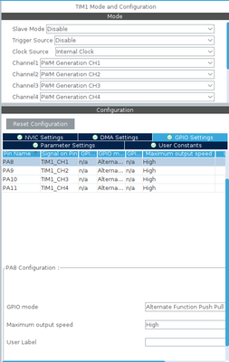

im kinda new to stm. how can i set up pin speed on cubeIDE can you guide me on that one too i would be very appreciated. thanks for your replies

-- just in cube ->
2023-12-19 2:05 AM
i cant configure that cubeIDE does not allow me to change those pins why is that? any idea ?
2023-12-19 2:08 AM
okay i found it it is on the System Core-> GPIO section thank you very much again
2023-12-19 3:08 AM
+ or scrolling down can show new things...
