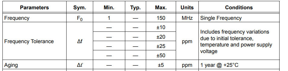

2022-04-15 4:36 PM
The offset each has in ppm?
Why not use a common clock source?
