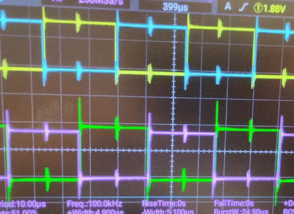

Trying to make a phase shift PWM for a DAB converter, i managed to do this exact functionality with normal TIM1 (Asynchronous mode), but im very very lost with HRTIM.
I am able to produce complementary PWM signals for TIMA1 and TIMA2, and TIMB1 TIMB2.
but no luck synching those TIMA and B with the HRTIM master timer.
I guess i just want to have control over that phase difference, babysteps...

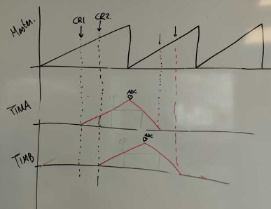

As i need to control the phase shift between timers maybe what i need is: (following paghe 34 AN4539 multiphase buck converter)
The master operates in continuous mode while the slave timers are in single-shot
retriggerable mode
Master Timer period= TIMA period = TIMB period
TIMA and B in up-down mode
  • TIMA reset on Master Compare 1
  • TIMB reset on Master Compare 2
  • TIMACH1 PWM TIMACR1
  • TIMACH2 NPWM + deadtime
  • TIMBCH1 PWM TIMBCR1
  • TIMBCH2 NPWM + deadtime
I was not starting the master timer >D thats why it wasnt working, code here https://github.com/javiBajoCero/getting-started-HRTIM-phase-shift-nucleoG4/tree/master

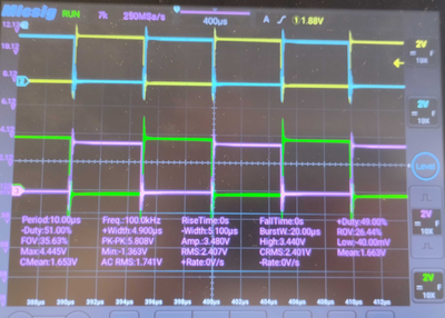

Edit:
By reading the HRTIM cookbook page 17
/* Start Timer A and Timer D */
 HRTIM1->sMasterRegs.MCR = HRTIM_MCR_TACEN + HRTIM_MCR_TDCEN;
 Im able to start both timers at the same time, that makes them be synchroniced.
Now how do i control the phase shift.
