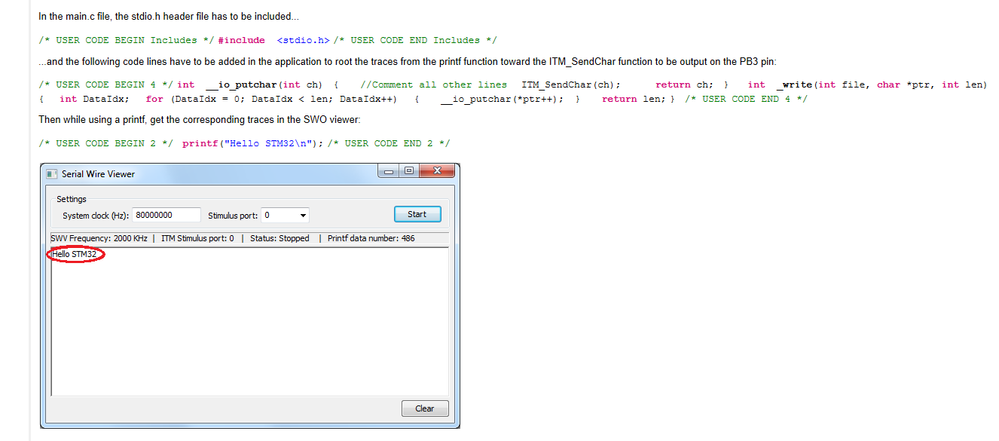

The tutorial showes this window but I can't get a hand on it:
2017-04-11 3:06 PM
That looks like the one from the ST-LINK Utilities. There is a tool-bar icon with 'SWV' in a terminal screen.
2017-04-12 2:36 AM
I confirm there's no SWV plug-in in SW4STM32 and you should use the one in ST-LINK Utility software.
