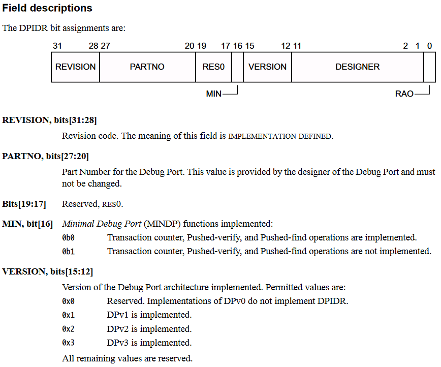

Thank you very much. Just for reference (from ADIv6.0:(
2022-02-16 8:32 AM
E.g. RM0399 decodes Debug port identification register (DP_DPIDR)
Bits 15:12 VERSION[3:0]: DP architecture version
0x2: DPv2
2022-02-16 10:09 AM
