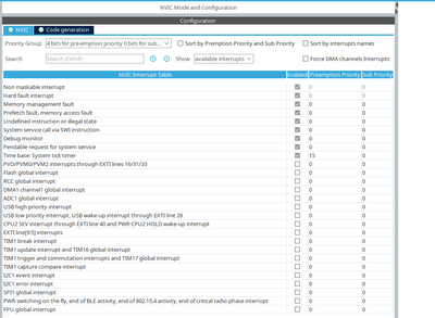

As for the ADC+DMA, if I generate the code without it, upload, everything works, re-generate with circular mode, change nothing else, re-generate and upload the STM32 won’t boot application code anymore. If I comment the MX_DMA_Init(); and MX_ADC1_Init();, then it boots again.
And I just realized that if I uncheck "Force DMA channels Interrupts" which allows me to uncheck "ADC1 Global Interrupt", then it can boot with circular mode and I can use the ADC fine... maybe there is something rotten in my NVIC which also prevents me from using SWD? Though it should work in bootloader mode I think...

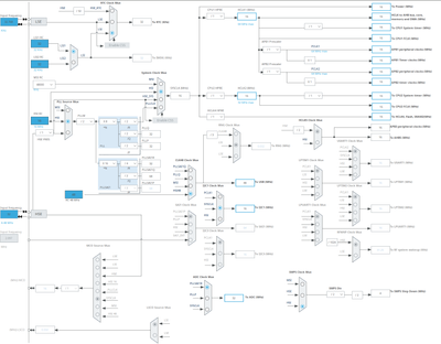

Here’s my current clock tree as well in case this could help
