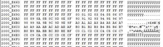

I have a strange behaviour, when I want to read the flash of an STM32U5A9 in a FreeRTOS task. I have a function, that programs incrementing numbers on a whole flash page of 8 KB (confirmed with J-Mem, that programming worked). If I want to read the flash and copy its content to a buffer, it works sometimes, but most bytes read 0xFF:Buffer content after trying to read flash with content 0x00, 0x01, ..., 0xFE, 0xFF
