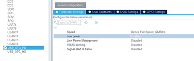

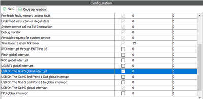

checking in STM32CubeMX, to have in NVIC table OTG wake-up EXTI line available
You need to allow "Low power" in parameter setting of your USB_OTG_xS device setting
Please check this setting and already existing USB examples in F4 family repository, which will guide you which code you need to add.

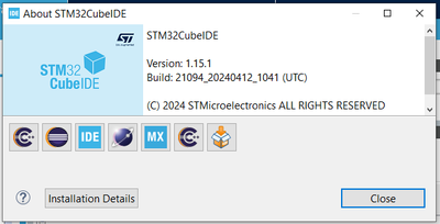

cube ide current version

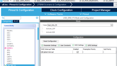

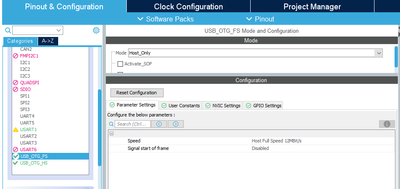

I see in your configuration Host_only mode. USB suspend is available only for USB device in STM32CubeMX, I also don't see any example showing USB host suspend, as it's very rarely requested.

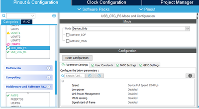

Device_Only Mode having low power option !!!!!!! but as you said Host_Only mode is suspend the low power option . even i have with checked Cube Mx separately and they also behave same condition .

In OTG_xS peripheral hardware there is support for both USB host or device with low power support for both modes. But in STM32CubeMX configuration or library example only USB device low power support is covered. So you can manage also USB host low power functionality, but more coding effort is required.

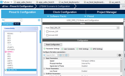

hi , i need add few more points on this subject .
G Series ,H5 series, L5 Series , U5 Series controller having low power option in host mode but there is NO USB wake up interrupt call . these controller having Type C option as per cubemx .
USB HOST +HID +USB Keybord is amazing option for wake from sleep mode and it can performance can be computer wake up by keyboard like wise Stm32 MCU + keyboard + wakeup can be mini computer . if you feel these findings are correct then please forward to Development Team
