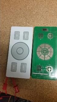

8 Pads, Standard mono. The current touch pad IC is a Freescale MPR083
The current software only needs to the detect touch and release of each pad.
I've attached a photo of the PCB pads
Thanks for your help

Thierry GUILHOT
Posted on November 04, 2015 at 12:20
Hi Darren,
Please find below the correponding table and declarations:
1. tsl_linrot.c file
// 8 CHANNELS - ROTARY - MONO
// i.e. CH1 CH2 CH3 CH4 CH5 CH6 CH7 CH8
#if TSLPRM_USE_8CH_ROT_M > 0
CONST TSL_tsignPosition_T TSL_POSOFF_8CH_ROT_M[8][8] =
// sec = 1     2     3     4     5     6     7     8
//   j = 0     1     2     3     4     5     6     7
     {   0,  -24,    0,    0,    0,    0,    0,  120 }, // maj = 1; i = 0
     {   8,    0,  -40,    0,    0,    0,    0,    0 }, // maj = 2; i = 1
     {   0,   24,    0,  -56,    0,    0,    0,    0 }, // maj = 3; i = 2
     {   0,    0,   40,    0,  -72,    0,    0,    0 }, // maj = 4; i = 3
     {   0,    0,    0,   56,    0,  -88,    0,    0 }, // maj = 5; i = 4
     {   0,    0,    0,    0,   72,    0, -104,    0 }, // maj = 6; i = 5
  {   0,    0,    0,    0,    0,   88,    0, -120 }, // maj = 7; i = 6
  {-136,    0,    0,    0,    0,    0,  104,    0 }  // maj = 8; i = 7
#endif
2. tsl_linrot.h file
#define TSL_SCTCOMP_6CH_ROT_M  ((TSL_tNb_T)( 32))
Note that for optimum performances, all the channels must be acquired simultaneously. This implies that 8 analog I/O groups should be used. If not, this can introduce some side effects as the result of acquisition will be not extracted at once but in several phases. Between each phase, the touch can move slightly. This can thus introduce a wrong reporting of the touch position.
Best Regards,
Thierry,
