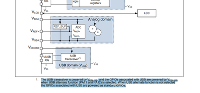

Are you sure VDDUSBIO is connected to 3.3V? Would you share USB schematic sheet?
2024-09-18 2:01 PM
Hi I checked the VDD USB, that one is tied to 3.3V as per recommendations.
