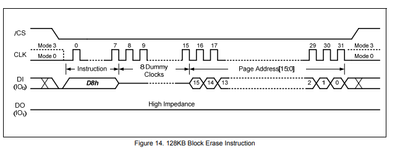

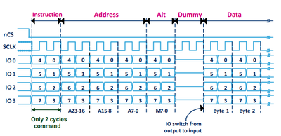

Hello @Dracu ,
Could please check if this NAND memory is supported by Quad-SPI interface?
NAND memory are supported if the command format is in line with the QUADSPI controller frame format (AN4760):
But, according to the memory datasheet, Block Erase (D8h) command needs the address after the dummy bytes.
Thank you.
Kaouthar
2023-11-13 9:33 AM
Hello @KDJEM.1 ,
That is why I am sending the address after the dummy clocks with:
HAL_QSPI_Transmit(&hqspi, block_add, 1000U) != HAL_OK)
