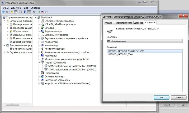

But in device manager, i have these devices:
So, drivers is installed, but it's not work. One interesting detail - in error PID = 5741, but in dev manager PID = 5740.
