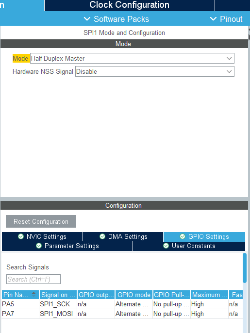

On my last question, I realize it's not maybe so clear. So let me be more precise on this. Here is how I plan to assign pins:
As you see, the other pins from the SPI3 and SPI1 (MISO, RDY, NSS) are not utilized. My question is: are those unused pins (SPI3-MISO, SPI3-RDY, etc....) available for other different I/O applications, (relay driving, etc...), or the fact that I 'enabled' SPI1 and SPI3 is forcing those SPI3-MISO, SPI3-RDY, ... pins to be dedicated to the SPI application only ?
Thank you very much again !
2025-06-09 4:11 AM
If you create in MX simple check on GPIO part for peripheral how pins is used, other is free ta any purpose.
