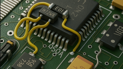

2025-06-26 7:58 AM
Internal pullups are not suitable as I2C pullups - much too high resistance.
Does the I2C slave device(s) have accessible pins?
Are there testpoints on the I2C lines? Vias?
Nothing specific to STM32 here - this is just general prototype/rework stuff.
Image credit: https://www.circuitrework.com/services/circuit-board-modification.html

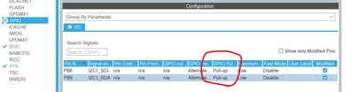

2025-06-27 6:55 AM
This post makes no sense. AI slop? Just not reading?
This is what I wrote:
> You can use the internal ~40 kOhm pullup resistors with reduced I2C clock rate, maybe 10 kHz, and it'll work just fine.
This is what you asked (again)
> Can pull-ups be enabled via STM32CubeIDE or firmware?
The answer is still yes.
