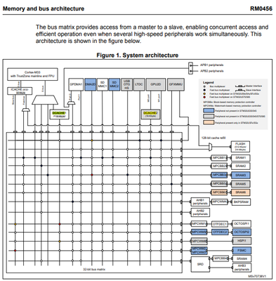

First let me thank you for all the insights and proposals. Maybe it would be more convincing if we have only DCache1. However,
STM32U5xx product embeds 2 DCACHE 16KBytes each: DCACHE 1 dedicated to external memories and DCACHE 2 placed on GPU2D M0 port and dedicated to improving performance of data traffic to/from external and internal memories. From application perspective, these features allow better performance close to zero wait state data access and lower power consumption when addressing small internal DCache.

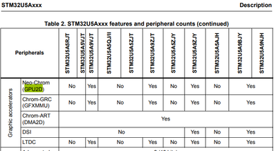

Thank you for the clarification @tjaekel
Indeed, U5A5x does not have GPU2D. Sorry for the confusion, U5A9x does have GPU2D.

Thank you @tjaekel for teaching me this valuable lesson :beaming_face_with_smiling_eyes:
Indeed, DCACHE2 is only addressable by GPU2D
