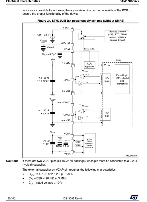

2. On page 150 of DS13086, STM32U585xx datasheet, regarding power supply scheme, I can see the presence of VDDIO2 like below,

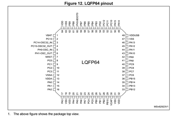

But on LQFP64 pinout for STM32U585RIT6 doesn't have any VDDIO2 but three VDD pins.
Does this mean some of the I/O pins are supplied with voltage from some of these VDD pins, instead of VDDIO2 cuz there is no such pin on LQFP64 package?

According to table 27, VDDIO2 pin is not available in LQFP64 package.
Some pins are supplied by VDDUSB or by VDDA, please refer to table 26.
