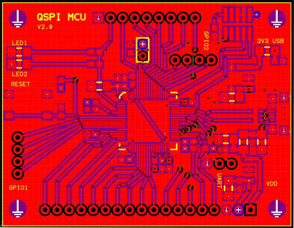

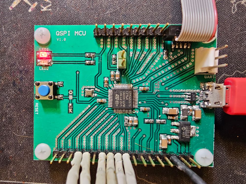

Here my board:

But I could cry... "rrrrrr"
using USB needs to power MCU with 3V3!
My board, with 48pin STM32U575CIT6Q (LQFP48), runs fine with 1V8 LDO:
I can connect via the debugger, I can flash FW ...
BUT: the USB does not work! (no VCP UART).
Changing to 3V3 LDO - all works fine.
(all what I have read: yes, USB needs 3V3)
So, STM32xxx MCU does not work with VDD 1V8 - USB is "broken"!
This small package does not have an option for several VDDs, all the same, I think.
Pretty annoying - why STM cannot make USB FS inside chip working even at 1V8?
"rrrrrrr" (now this MCU is off from my list to be used for my purpose: QSPI testing with 1V8

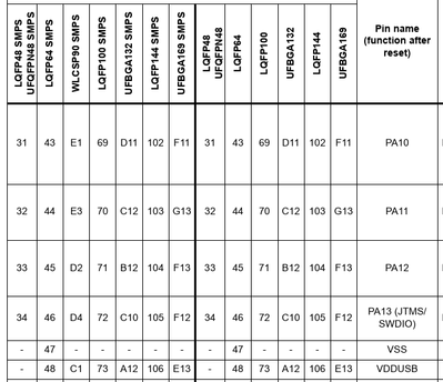

Well the 48-pin doesn't look to export the VDDUSB supply for the USB pin drivers.

VDDUSB has to be 3V3 , because usb interface signals are at 3V3 level,
see ds: 48pin is the only case, without separate usbvdd, so pin bonded to vdd internal;
if you want separate usbvdd , minimum is 64pin case;

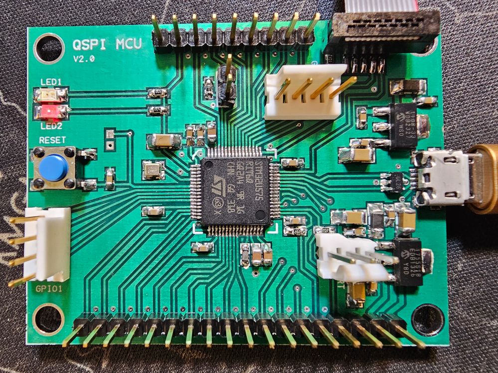

I have redesigned my PCB: now with LQFP64 package, which has VDDUSB (set to 3V3).,
