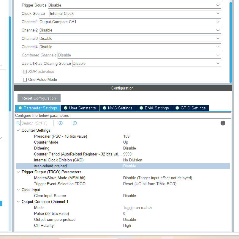

htim4.Instance = TIM4;
htim4.Init.Prescaler = 159;
htim4.Init.CounterMode = TIM_COUNTERMODE_UP;
htim4.Init.Period = 9999;
htim4.Init.ClockDivision = TIM_CLOCKDIVISION_DIV1;
htim4.Init.AutoReloadPreload = TIM_AUTORELOAD_PRELOAD_DISABLE;
if (HAL_TIM_Base_Init(&htim4) != HAL_OK)
Error_Handler();
sClockSourceConfig.ClockSource = TIM_CLOCKSOURCE_INTERNAL;
if (HAL_TIM_ConfigClockSource(&htim4, &sClockSourceConfig) != HAL_OK)
Error_Handler();
if (HAL_TIM_OC_Init(&htim4) != HAL_OK)
Error_Handler();
sMasterConfig.MasterOutputTrigger = TIM_TRGO_RESET;
if (HAL_TIMEx_MasterConfigSynchronization(&htim4, &sMasterConfig) != HAL_OK)
Error_Handler();
sConfigOC.OCMode = TIM_OCMODE_TOGGLE;
sConfigOC.Pulse = 0;
sConfigOC.OCPolarity = TIM_OCPOLARITY_HIGH;
sConfigOC.OCFastMode = TIM_OCFAST_DISABLE;
if (HAL_TIM_OC_ConfigChannel(&htim4, &sConfigOC, TIM_CHANNEL_1) != HAL_OK)
Error_Handler();

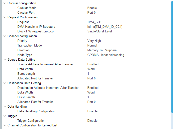

NodeConfig.NodeType = DMA_GPDMA_LINEAR_NODE;
NodeConfig.Init.Request = GPDMA1_REQUEST_TIM4_CH1;
NodeConfig.Init.BlkHWRequest = DMA_BREQ_SINGLE_BURST;
NodeConfig.Init.Direction = DMA_MEMORY_TO_PERIPH;
NodeConfig.Init.SrcInc = DMA_SINC_INCREMENTED;
NodeConfig.Init.DestInc = DMA_DINC_INCREMENTED;
NodeConfig.Init.SrcDataWidth = DMA_SRC_DATAWIDTH_WORD;
NodeConfig.Init.DestDataWidth = DMA_DEST_DATAWIDTH_WORD;
NodeConfig.Init.SrcBurstLength = 1;
NodeConfig.Init.DestBurstLength = 1;
NodeConfig.Init.TransferAllocatedPort = DMA_SRC_ALLOCATED_PORT0|DMA_DEST_ALLOCATED_PORT0;
NodeConfig.Init.TransferEventMode = DMA_TCEM_BLOCK_TRANSFER;
NodeConfig.Init.Mode = DMA_NORMAL;
NodeConfig.TriggerConfig.TriggerPolarity = DMA_TRIG_POLARITY_MASKED;
NodeConfig.DataHandlingConfig.DataExchange = DMA_EXCHANGE_NONE;
NodeConfig.DataHandlingConfig.DataAlignment = DMA_DATA_RIGHTALIGN_ZEROPADDED;
if (HAL_DMAEx_List_BuildNode(&NodeConfig, &Node_GPDMA1_Channel6) != HAL_OK)
Error_Handler();
if (HAL_DMAEx_List_InsertNode(&List_GPDMA1_Channel6, NULL, &Node_GPDMA1_Channel6) != HAL_OK)
Error_Handler();
if (HAL_DMAEx_List_SetCircularMode(&List_GPDMA1_Channel6) != HAL_OK)
Error_Handler();
handle_GPDMA1_Channel6.Instance = GPDMA1_Channel6;
handle_GPDMA1_Channel6.InitLinkedList.Priority = DMA_LOW_PRIORITY_HIGH_WEIGHT;
handle_GPDMA1_Channel6.InitLinkedList.LinkStepMode = DMA_LSM_FULL_EXECUTION;
handle_GPDMA1_Channel6.InitLinkedList.LinkAllocatedPort = DMA_LINK_ALLOCATED_PORT0;
handle_GPDMA1_Channel6.InitLinkedList.TransferEventMode = DMA_TCEM_BLOCK_TRANSFER;
handle_GPDMA1_Channel6.InitLinkedList.LinkedListMode = DMA_LINKEDLIST_CIRCULAR;
if (HAL_DMAEx_List_Init(&handle_GPDMA1_Channel6) != HAL_OK)
Error_Handler();
if (HAL_DMAEx_List_LinkQ(&handle_GPDMA1_Channel6, &List_GPDMA1_Channel6) != HAL_OK)
Error_Handler();
__HAL_LINKDMA(tim_baseHandle, hdma[TIM_DMA_ID_CC1], handle_GPDMA1_Channel6);

Using GPMDA to perform PWM comparison output on STM32U757. Only the first pulse conversion period is 3ms, and the others are 10ms. Additionally, the CCR values of other channels are also modified.

Hello @caiChangKun,
This could be related to the config of your TIM/DMA, make sure ARR is strictly greater than the CCR value

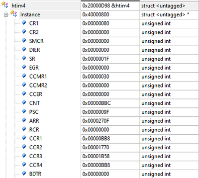

Yes, my ARR value is greater than the CCR value. The issue is that only the first 3000 value is effective. I am only sending the CCR value to channel 1, but the values of my other channels are also being changed. Why is that?
