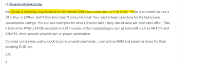

I found a clue in the post below, but I have no idea what the register name is, and I couldn't find it in the STM32U575 manual.
