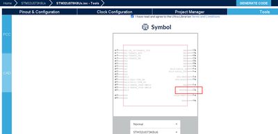

FYI.
The symbol generated by STM32CubeMX also has the wrong signal name.
I will be updated once the new doc is published.
Best Regards.
STTwo-32
