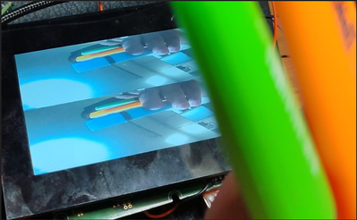

}With this configuration I see double images in the screen. What could be wrong with it?

Please attach a screenshot of the screen or the display configuration. The issue is more likely related to the display rather than the DCMIPP or the sensor.
(No overrun on dcmipp or any other error ? frames received correctly ?)
Best regards.

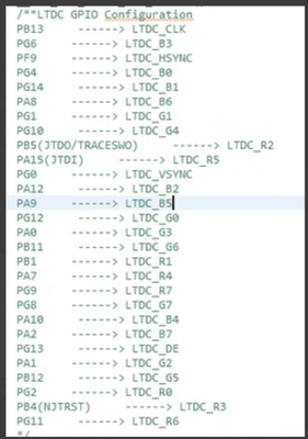

2025-06-20 3:13 AM - edited 2025-06-20 3:32 AM
Display output looks like this.
For the display side LCD 24bit RGB interface

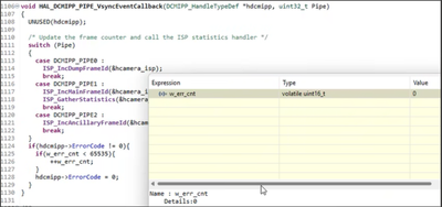

Also I added an error counter in to the code and run the code many times but there is no error received.

2025-06-20 4:32 AM
It looks correct ,
while(1){
/* Start DMA2D transfer*/
if(HAL_DMA2D_Start_IT(&hdma2d,
(uint32_t)AXISRAM4_ADDRESS, /* camera data */
(uint32_t)BUFFER_ADDRESS, /* LCD frame buffer address */
FRAME_WIDTH,
FRAME_HEIGHT) != HAL_OK)
Error_Handler();
}What is the purpose of this function? It seems you might not be managing the memory correctly, which could cause the display to show incorrect data.
The DCMIPP is used to dump data directly in the memory , allowing you to use the same frame address for display."
