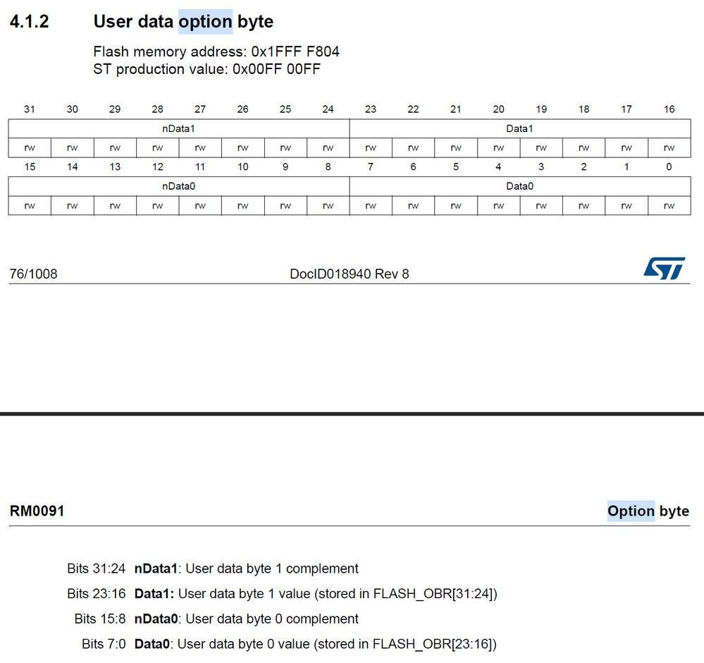

The F0 has areas within the option bytes which can be used for user data and are accessible via the flash interface. This is the reason it has HAL_FLASHEx_OBGetUserData and the L5 does not.
