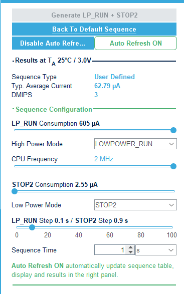

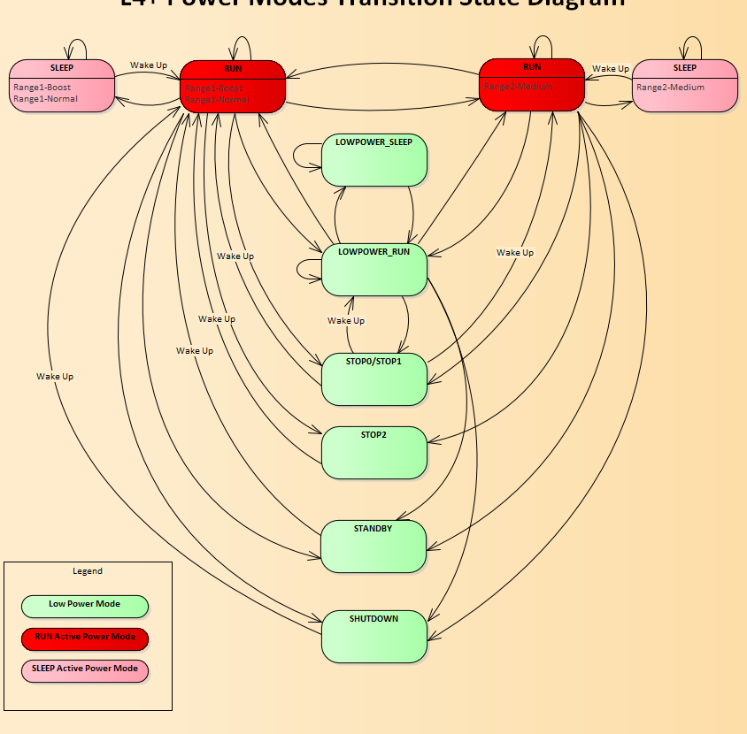

I'm getting mixed results checking up this question. In the power consumption calculator (PCC) there is the following diagram displayed:0693W00000JOq99QAD.pngAs you can see it should not be possible to enter STOP2 from LOWPOWER_RUN. However the sequence generator allows me to use it, even though its red underlined in the sequences:
Therefore I wanted to ask, is it possible to enter the STOP2 mode from low power run? And if not, why? I couldn't find an answer to the low-power manual from STM32, as well as the reference manual.

Hello @crackl1ng​ ,
Yes you are right. It's not possible to make the transition from LOWPOWER_RUN to STOP2. It's mandatory to pass through the RUN MODE.
