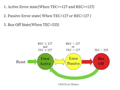

It could be a possible solution based on error confinement mechanism:

No I don't think disabling/enabling CAN clock will reset these counters as the registers keep their values when CAN Clock is disabled. You need to reset the peripheral for that.
