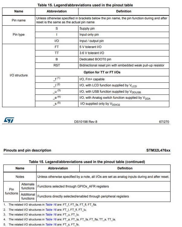

Hello, I use for STM32 (1.8V VDD) SPI communication with an slave temperature Sensor (3.5V basic voltage, detects high at 0,7*3,5V)
SCLK =PC10
SDO = PC11
SDI= PC12
CS = PC13
For that reason I want to use an external 3.5V Pullup. But I'm not sure if this is OK for pins
PC10/PC11/PC12/PC13. Can anybody tell me if this is OK?And where I can find these information in datasheet? I already looked in the AN4899 Application note, but coulkdn't find which pins are 5V tolerant. In special if PC10/11/12/13 are 5V tolerant.

Hello @FHopp.1​
You can refer to the STM32L476xx datasheet, and see the tables:
  • Table 15: Legend/abbreviations used in the pinout table
  • Table 16: STM32L476xx pin definitions table 0693W000006G18vQAC.png
Please mark my answer as best by clicking on the "Select as Best" button if it fully solved your issue. This will help other users find this solution more quickly.
