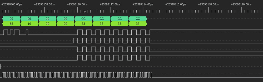

While doing heavy activity with a NAND flash, the code is generally working, but occasionally I get hung up waiting for an operation to finish. I trapped it on the logic analyzer several times, and it's never at the same time. In every instance the QSPI CLK, it stops after 16 bytes of indirect DMA transfer. It gets worse when I run faster.

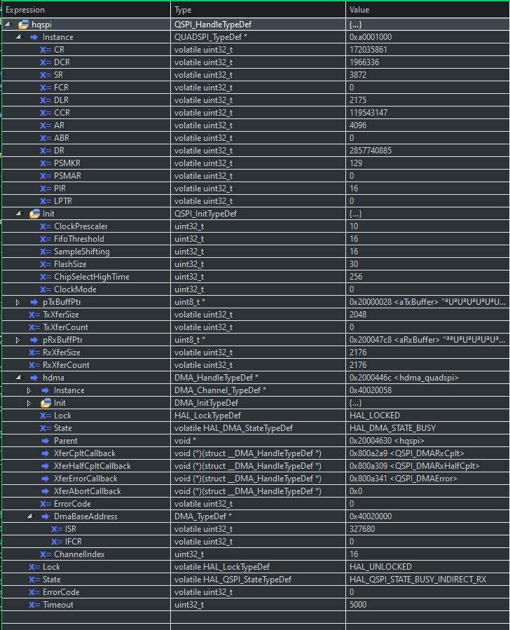

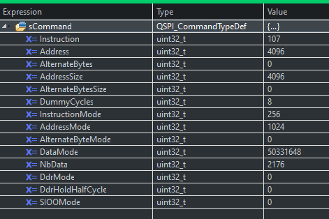

Here is the state when it happens:
And what a partial transfer looks like.

It's just the DMA controller stopping, and I timeout after 100ms.
HAL_QSPI_GetState() = 0x22 HAL_QSPI_STATE_BUSY_INDIRECT_RX
HAL_QSPI_GetError() = 0
HAL_DMA_GetState=2 HAL_DMA_STATE_BUSY
HAL_DMA_GetError() = 0
I have a HAL_QSPI_ErrorCallback() but it does not fire.
