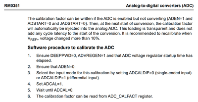

The reference manual RM0351 covers calibration procedure for the ADC.

Thanks TDK,
I followed the instructions in the manual to the letter, the ADC values changed somewhat, but they are still 10% out of calibration which seems way out. I have confirmed the VREF voltages and the input voltages to the ADC pins and added delays of 250ms between turning on the ADC and performing the calibration steps as some others have suggested . I have even hardcoded the registers - bad practice but I can't access register values directly as they don't appear in the header file. So for instance DEEPPWD is not a member of the CR register.
I'm not too sure where to go from here.
Any advice would be appreciated if you have time. Thank you.
