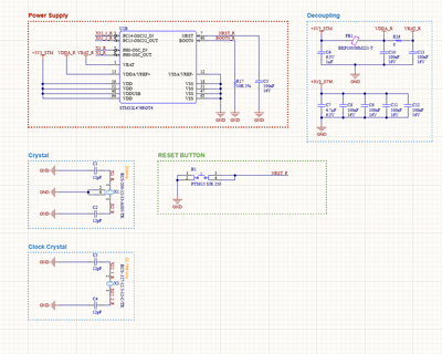

What is the clock? How is it used? Is there any LSE clock/VBAT? You may perhaps want to post relevant portion of schematics.

Added the schematics for the clock HSE and LSE, and power inputs.

Nonetheless, if the waveform you've shown is VBAT, regardless of whether it is connected to VDD/VDDA or both, if it goes below ground i.e. to negative as much as you've shown, that may be a concern too, and may have resulted in latchup; so you may want to eliminate that possibility first, by reviewing the power supply arrangement.
