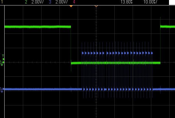

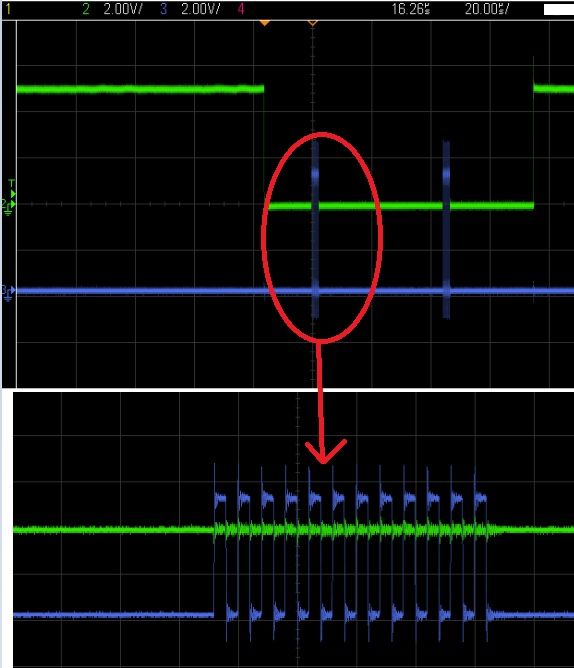

in using standard library , the ADC reading is ok as bleow fig.
in using hal library, the ADC reading is not good as bleow fig.
