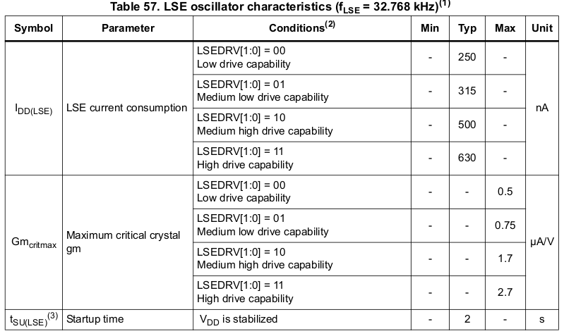

Load capacitors used: CL_1 = CL_2 = 8pF
With Drive Level of Low the application works. I would like to obtain better understanding of how the G_m_crit_max is connected to the CL.
I've had a look at AN2867 - Oscillator design for STM32 MCUs.
According to section 4.1, a better Drive Level would be the Medium?
Moreover the STM32L496xx Datasheet has this table:
2020-01-17 7:31 AM
A 12.5pf crystal with 8pF load caps is severly underloaded, you will need approx 18pF load caps (depending on PCB) Most likely the highest drive level will be needed.
I would not recommend to use a 12.5pF crystal, go with 8pF or 9pF instead (and 10-12pF load caps)
