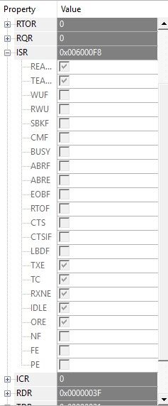

Have checked with a scope, i.e. is this a real received character ?
always I have Overrun Error after sending a command....

I suspect you spend too much time in an interrupt routine, be it a differnt interrupt, the send callback, or even the receive callback itself.
If a character is received while another unread character is still in RX, the overrun flag is set, and reception stops - until you explicitly reset the OR flag.

In the way I'm working, I send a command via UART and then I have to read something. Every time I send a command, the status of the ISR register is as depicted in the attached picture (it has been catched being stopped at 'HAL_UART_TxCpltCallback' function): always I have Overrun Error after sending a command....
