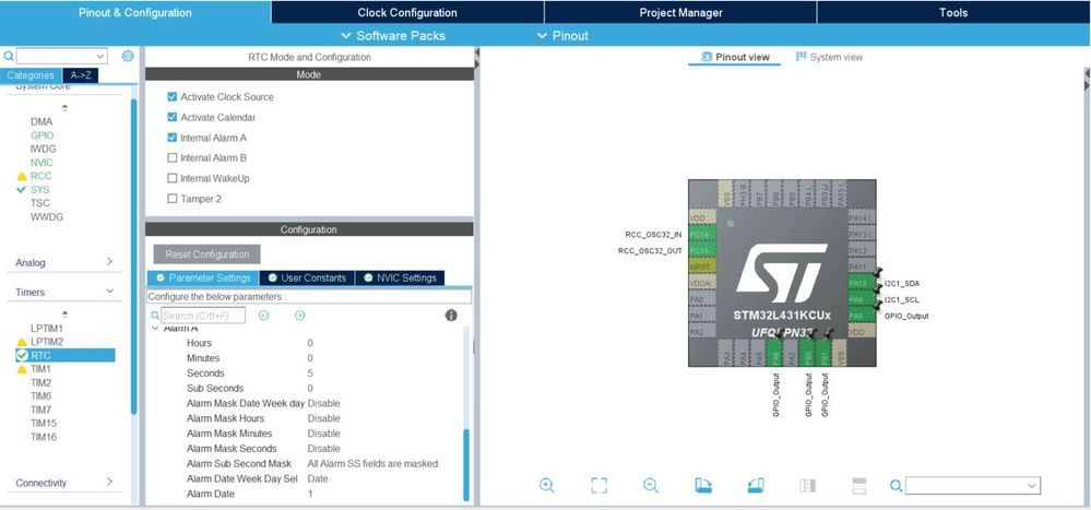

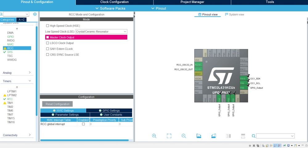

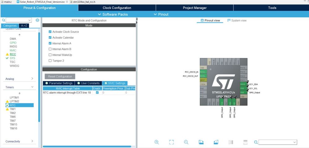

I am using STM32L431 and the device is not waking up from STOP mode with an RTC alarm interrupt. Can somebody pinpoint where my issues are?
My configurations in the code configurator:
I am enabling the crystal oscillator, enabling the calendar, alarm, and the interrupt through EXTI18, the only parameter I change is the time of the alarm set to 5 seconds.

/** Enable the Alarm A
sAlarm.AlarmTime.Hours = 0x0;
sAlarm.AlarmTime.Minutes = 0x0;
sAlarm.AlarmTime.Seconds = 0x5;
sAlarm.AlarmTime.SubSeconds = 0x0;
sAlarm.AlarmTime.DayLightSaving = RTC_DAYLIGHTSAVING_NONE;
sAlarm.AlarmTime.StoreOperation = RTC_STOREOPERATION_RESET;
sAlarm.AlarmMask = RTC_ALARMMASK_NONE;
sAlarm.AlarmSubSecondMask = RTC_ALARMSUBSECONDMASK_ALL;
sAlarm.AlarmDateWeekDaySel = RTC_ALARMDATEWEEKDAYSEL_DATE;
sAlarm.AlarmDateWeekDay = 0x1;
sAlarm.Alarm = RTC_ALARM_A;
if (HAL_RTC_SetAlarm_IT(&hrtc, &sAlarm, RTC_FORMAT_BCD) != HAL_OK)
Error_Handler();

2021-06-14 4:21 PM
Hi all,
I faced a similar problem...
if(EXTI->PR1 & EXTI_PR1_PIF18)
EXTI->PR1 |= EXTI_PR1_PIF18; ///< Clear pending interrupt if necessary
EXTI->EMR1 |= EXTI_EMR1_EM18; ///< RTC Alarm Mask
EXTI->RTSR1 |= EXTI_RTSR1_RT18; ///< Rising trigger
/* Set the alarm values with the config values */
HAL_PWREx_EnableInternalWakeUpLine();
__HAL_RTC_ALARMA_ENABLE(&hrtc);
__HAL_RTC_ALARM_CLEAR_FLAG(&hrtc, RTC_FLAG_ALRAF);
alarm_Time.Hours = storage_config.wup_time.Hours;
alarm_Time.Minutes = storage_config.wup_time.Minutes;
alarm_Time.Seconds = storage_config.wup_time.Seconds;
alarm_Time.DayLightSaving = RTC_DAYLIGHTSAVING_NONE;
alrm_a.Alarm = RTC_ALARM_A;
alrm_a.AlarmMask = RTC_ALRMAR_MSK4;
alrm_a.AlarmDateWeekDay = RTC_WEEKDAY_MONDAY;
alrm_a.AlarmTime = alarm_Time;
alrm_a.AlarmSubSecondMask = RTC_ALARMSUBSECONDMASK_ALL;
HAL_NVIC_SetPriority(RTC_Alarm_IRQn, 7, 0); ///< Set the interrupt priority and enable
HAL_NVIC_EnableIRQ(RTC_Alarm_IRQn);
HAL_RTC_DeactivateAlarm(&hrtc, RTC_ALARM_A);
if (HAL_RTC_SetAlarm_IT(&hrtc, &alrm_a, RTC_FORMAT_BIN) != HAL_OK)
log_msg(LOG_ERR, "dg_system.c: Error setting alarm Line: %u", __LINE__);
log_msg(LOG_INFO, "Setting alarm: %02d:%02d:%02d", alrm_a.AlarmTime.Hours, alrm_a.AlarmTime.Minutes, alrm_a.AlarmTime.Seconds);The log_msg function us a printf wrapper. I don't know if this is the most elegant or efficient way... probably not, but it works. I'll see what code is unnecessary and remove it later on.
