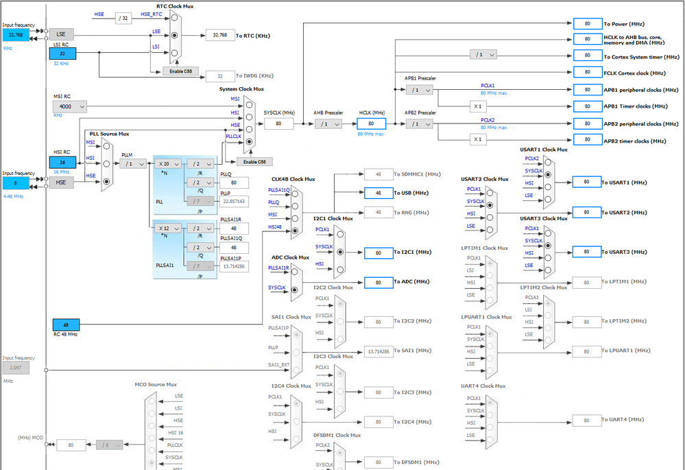

I am using STM32L452VET. I have generated the startup code using latest STM32CubeMX 4.22.1. Here is my clock config:

what does your RCC_OscInitStruct look like? Does it define PLL.PLLM? this is a bug in the current CubeMX application.

You are right. The initialization of RCC_OscInitStruct.PLL.PLLM was missing in the generated code. After adding the line:
RCC_OscInitStruct.PLL.PLLM = 1;Before the HAL_RCC_OscConfig, everything works. I am wondering why was it working on better optimization levels....
Anyways seems like it is a bug indeed. Thank you very much for help.
