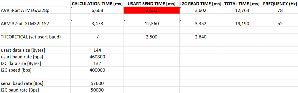

thank you for all your answers and suggestions. I admit I was rather vague in my explanation... Anyway, today I have debugged the code (rather three separate modules, i.e., serial communication, I2C communication and calcultion) using the oscilloscope. I wrapped a pin toggle function around my three modules for both micro controllers and compared the results (execution time):2014-01-08 1:59 AM

Hi K
I think you have found all the issues. You have shown that raw processing power of the STM32 is better than the Atmel: Calc time : Atmel - 6,608ms vs STM32 3,478ms You have worked out why the Atmel SEEMS faster: USART send time : Atmel 2,553ms vs STM32 12,360ms (The Atmel does not seem to be complying with RS232 baud rate!) ''the AVR chip is on a standalone custom built board and the Tx and Rx pins are connected to a serial transceiver'' USB transceiver by any chance? USB virtual COM ports can be faster than the set baud rate! ''Please tell me, how can I check the HCLK clock frequency properly?'' By all means - check the clock for your own peace of mind. ''Regarding the DMA - I do not know a lot about DMA. As far as I have read about it, I think I do not need DMA, since I have to wait for the data to be ready (using a peripheral that has its own processor to fill its data buffer) every loop iteration anyway. Or am I wrong?'' You are right - DMA is best for transferring larg(ish) blocks of data when the data is ready. It is no magic bullet. Most people do not realize it can actual stop the processor! In order for DMA to do it's job - it needs full access to the address and data bus. Which ever starts first (processor or DMA) has priority over the bus - meaning that if DMA starts first - it can block the processor core. Yes, it depends on the bus topology. Yes, DMA is faster than code loops. (However, DMA is specific to each processor peripheral core and can be tricky to set up and usually involve IRQs - meaning that sometimes the extra complexity out weighs the simple code loop) Use appropriately.2014-01-09 3:07 AM
regarding the CPU performance, I admit I stated this wrong. Actually I don't really care benchmarking the CPU performance. My reference is the overall let's say ''loop'' execution time. Based on the test, it is clear that the difference is in the serial communication, although I do not know how this is possible, since the baud rates are initialized to the same value + the receiver end is initialized to the same baud. And the data on the receiver side seems ok! I will check the clock directly on the Tx pin. Thank you and best regards, KWe’re moving the ST Community to a new platform to give you a better and more reliable community experience.
