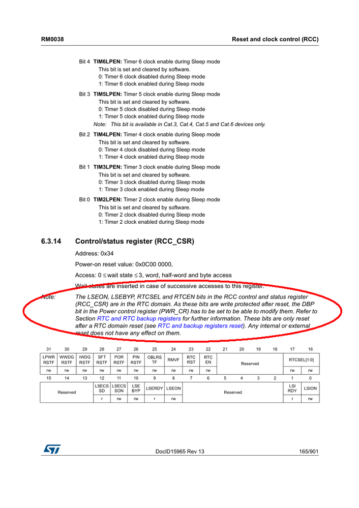

I want to use STME32L152 with LSE for RTC.
I set the bit LSEON in the register RCC_CSR but the bit remains always 0. I proceeded the same with LSION and it is working well.
I disable also the bit LSECSS and behavior is the same.
The LSE oscilator didn't start.
There is another condition to starting LSE?

2019-08-21 1:41 AM
Note that PWR needs to have enabled clock in RCC previously.
2019-08-21 4:12 AM
thank you for the answers
I tried your advices
LSEON is still kept to 0. (also LSERDY)
I set the bit BDE from PWR_CR register, set LSEON.
The quartz doesn't work(physically) and for this reason LSERDY is kept to 0 logic.
