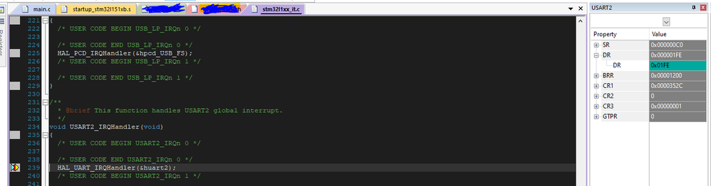

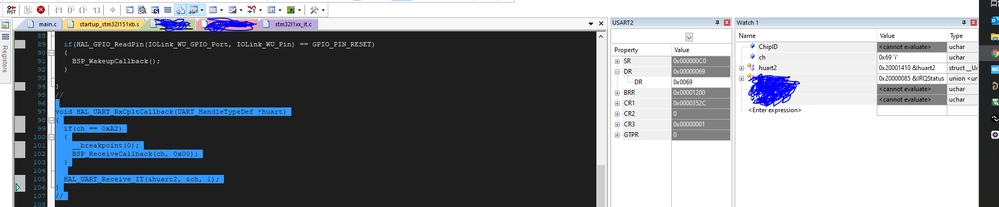

2021-10-31 10:11 PM
What do you mean by "The clock rate is likely off."? Do you mean there is something wrong with systick or internal/external clock source?
I am going to share related screenshots here.

> How are you receiving 9 bits when it's configured for 8 bits?
I configured my USART2 to 9 bits. Why did you say that? Here is the configuration. Am I missing something?

2021-11-01 10:29 PM
I am not sure why did you thinking that I am changing the baud but I am not. At least not on purpose.
I found the problem and what was causing it and I fixed it.
The problem was, somehow baud rate changed after my UART init function. That was why I could not be able to receive the correct value/data.
