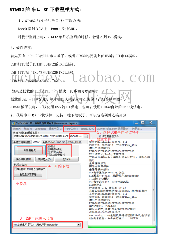

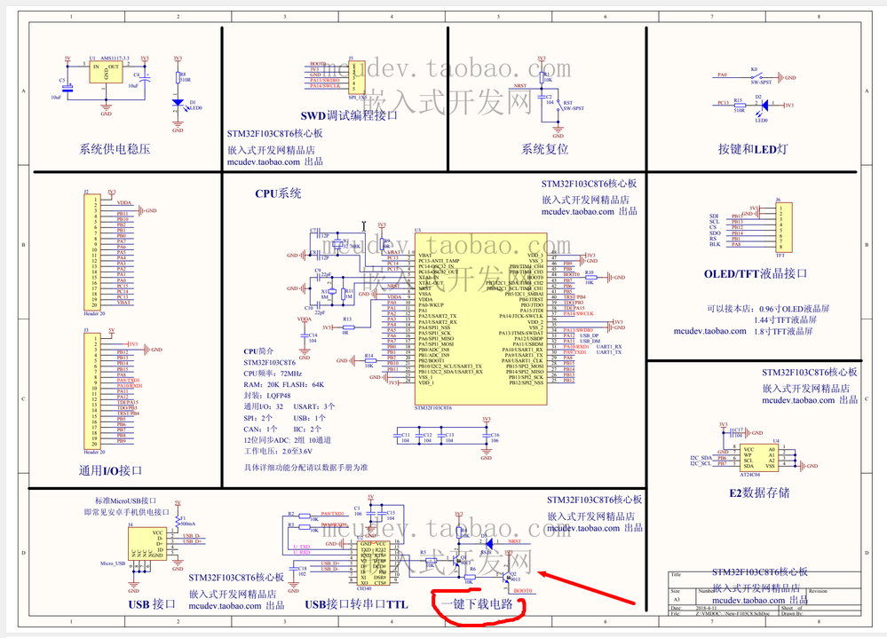

xwang.6
Associate III
0693W00000YAYc8QAH.png0693W00000YAYqMQAX.png Please refer to Figures 1 and 2,Use software FlyMcu to download the program to PCB via USB to serial port( STM32 USART1)
