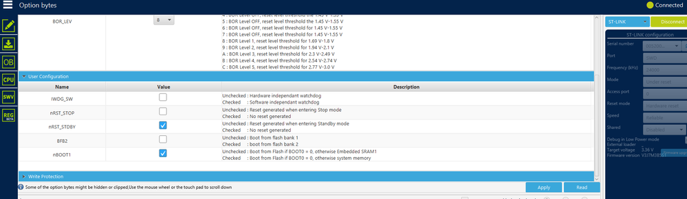

2022-03-21 2:28 AM
So now It is clear. I had unchecked WDG_SW - it means the IWDG was activated by harware and this is why the reset occured.
What I do not understand is why this bit was unchecked.

When check IWDG - so by stm32CubeProgrammer is disabled. I can say that I do not modify any options byte in my code and I flash it only from STM32Ide by Jlink programmer. I do not really understand this behaviour :(

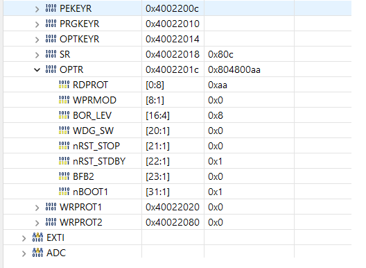

2022-03-17 1:44 PM
Current state:
It looks like the IWDG is activated despite the factI didn't allow it?!?
