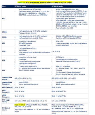

It appears I cheered too soon, after I dived into the U083 datasheet and pin functions: The STM32U0 misses the second MCO output on PB13(pin 34) and the USART on PB3-PB4 (pins 55-56), where the L07x has USART5.
That results in quite a bit more redesigning than only disconnecting the unused USB power.
I guess that the AN6091 document should warn in Table 21 that USART pinout compatibility is partial and in Table 25 that the second MCO output of the L07x is not available on U0 series.

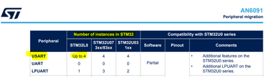

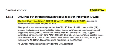

The STM32L073 has a four USART (USART1, USART2, USART4 and USART5) as mentioned in the datasheet:
And in AN6091 application note table 21 you can see that the number of USART instances in STM32L0 is up to 4.
I think, the AN6091 is in line with STM32L073 datasheet.
For table 25. is a RCC differences between STM32L0 and STM32U0 series that mean is applicable for all STM32L0 series and for all STM32U0 series.

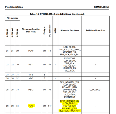

For example in STM32L063, the MCO is not available in pin PB13 as shown in STM32L063 datasheet.
As table 25. in AN6091 is applicable for all STM32L0, only PA8 is mentioned which is supported by all STM32L0 series.
