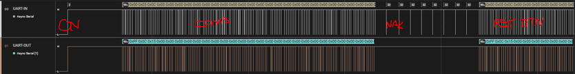

I am working with a custom board communicating via USB-2-USART IC (FT234XD-R). Upon power up, the board operates as expected. I can communicate with the device . After some time--usually 60sec or so, but not perfectly periodic-- the device will stop responding. Using a logic analyzer, it shows the FT234 is still sending data to the chip, but the chip is not responding.The graph below shows a power up, communications start, MCU stops responding and reset button restores COMS indefinitely. I have left the board running for 24hrs and do not see the same issue after reset.

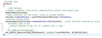

HAL_UARTEx_ReceiveToIdle_DMA(&huart2, (uint8_t*)uartRxBuffer, RX_BUFFER_MAX);
Callback structure

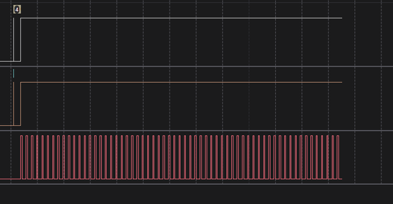

Answer 1: When not communicating with the board. I do not see a reset, so thus the watchdog is getting pet and all is well. I do not believe there to be problematic code outside of the information I have presented. If the board were reset by the watch dog, we would see an anomaly int the heart beat pulse in red seen below.

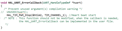

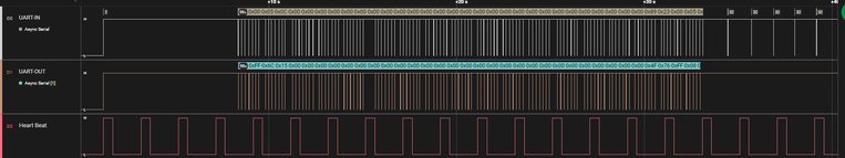

Answer 2: I checked that the UART error callback is not called and checked the interrupt was enabled. (Watch dog is disabled now so I can glimpse into the issue) From the graph you can see that COMS start and everntually the MCU stops responding. In my UART error callback I turn off the heart beat light PWM, but notice that it never reaches that block of code from the graphs perspective.
Question 3(Karl Yamashita:( HAL_UARTEx_ReceiveToIdle_DMA returns busy & dead in the water
Answer 3:As a quick check if this would be the culprit, I put the HAL_UARTEx_ReceiveToIdle_DMA right in my main loop to be consistently re-initialized. From the graph, you can see that the issue still arises.
